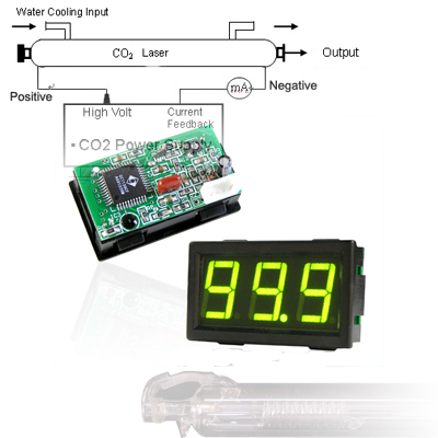

Always connect to the negative side of the power supply. Don't do it on the Positive(+) side or it will blow it. See picture attached.
Some meter may comes with a little shunt (resistor). Just put it in series with the power supply and the tube. Then, connect the input pins from the current meter across on the two side of the shunt and you can read the current.

Ok thanx MarcoTech_Marco wrote:Always connect to the negative side of the power supply. Don't do it on the Positive(+) side or it will blow it. See picture attached.

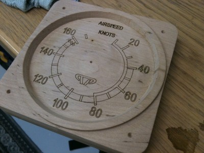

Today works
and many test leather and acryl

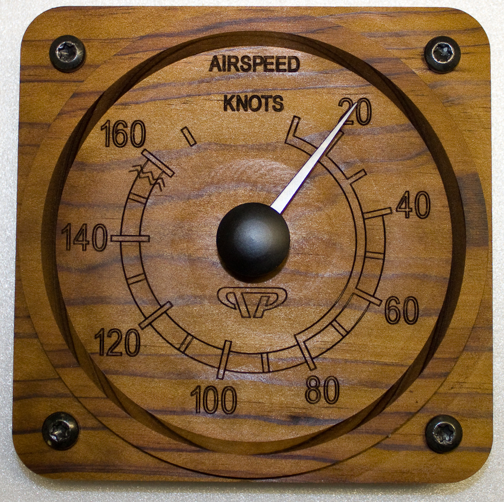

did you have already components? Today the product itself 20pcs saunameter two different models
alder and radiata pine, the first CNC has the bottom and then the laser pattern.
Alder radiata pine
Alder radiata pine

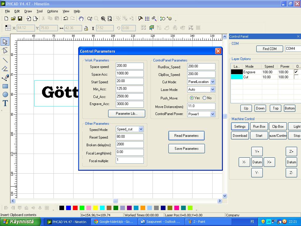

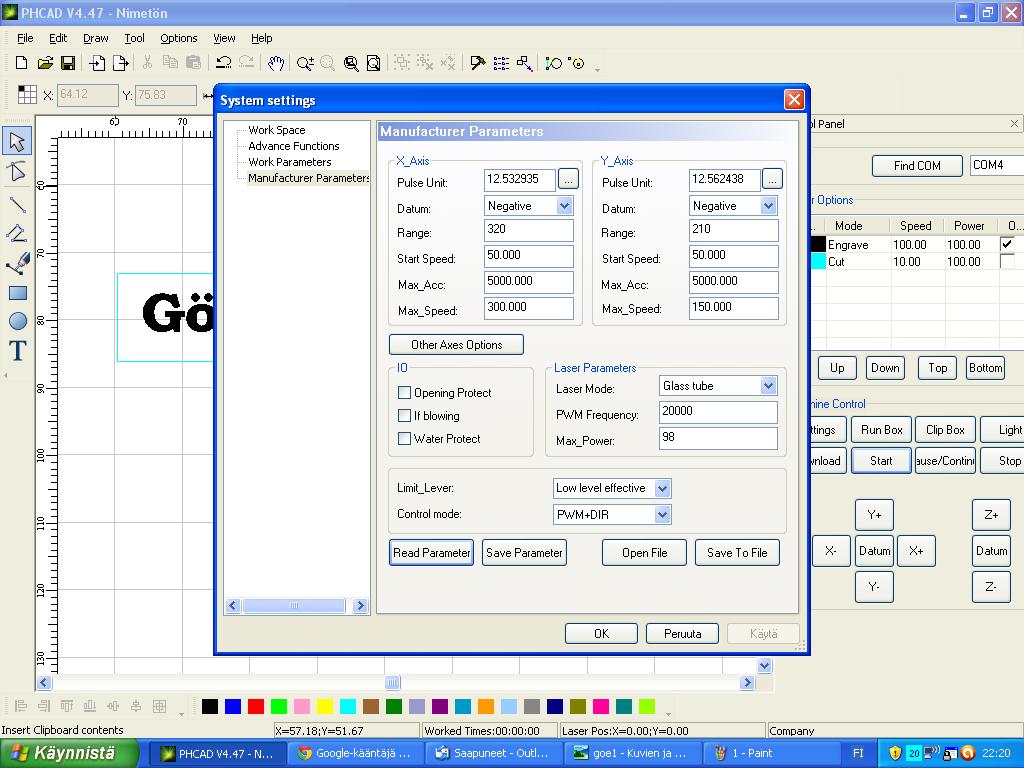

I tried cutting a basic circle to start with but when i sent the circle image to the laser it instead engraved 31 straight lines one above the other spaced about 0.5 mm apart and each line was 70mm long. No idea where it's getting that information from.
I then copied your settings on page 3 of this thread (as i have no idea how to program these things) and now it says "not enough extend space please esc" which i understand from an earlier post is because the image is to close to the edge of your usable area however i have tried moving the image to different parts of the page but still getting the same message.
TeacDance
- Posts: 95
- Location: Finland
You have to change cut if you want to cut circle not engrave..Urbantrix wrote:Thanks for all the advice Teacdance. I'm now fully connected up.

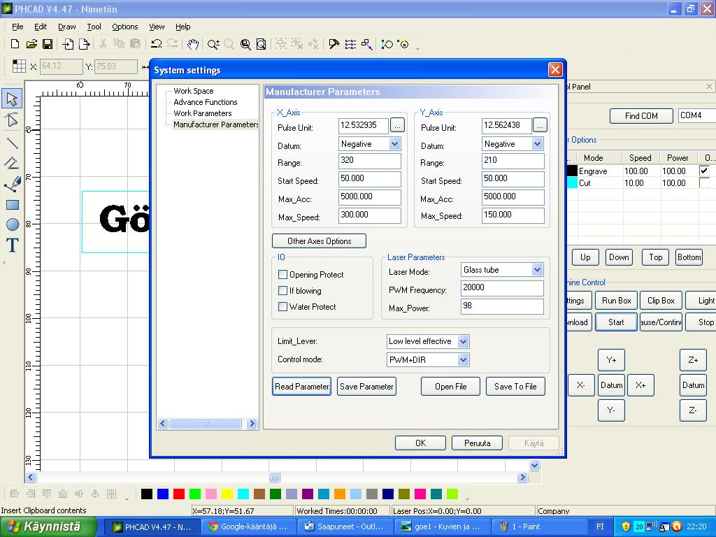

Here is my setup this moment those page 3 is my earlier setup
this setup works fine to me
manufacture parameters Control parameters
