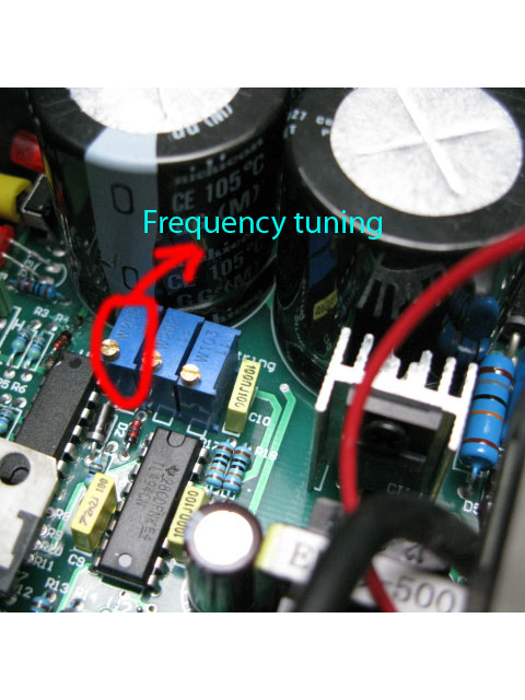

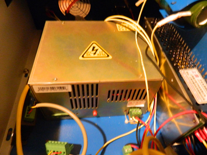

You may do 5 to 10 turns "counter-clockwise" on that potentiometer (VR). Make sure to turn PS off before doing so to avoid accidentally shocking by the PS.
- PS40W-FreqTune.jpg (67.13 KiB) Viewed 6390 times
natsterrr
- Posts: 28
- Joined: Thu Mar 07, 2013 11:29 pm
Is there any way to know whether it has worked or not?Tech_Marco wrote:You may do 5 to 10 turns "counter-clockwise" on that potentiometer (VR). Make sure to turn PS off before doing so to avoid accidentally shocking by the PS.
Just press "Laser" on the LCD unit of DSP and you can tell. If it works, there should have no beam shoot out. Do it on a piece of paper. Assuming the 6 turns it stop, then you may want to add 2 more turns
natsterrr
- Posts: 28
I think it worked. Thanks Marco.Tech_Marco wrote:Just press "Laser" on the LCD unit of DSP and you can tell. If it works, there should have no beam shoot out. Do it on a piece of paper. Assuming the 6 turns it stop, then you may want to add 2 more turns

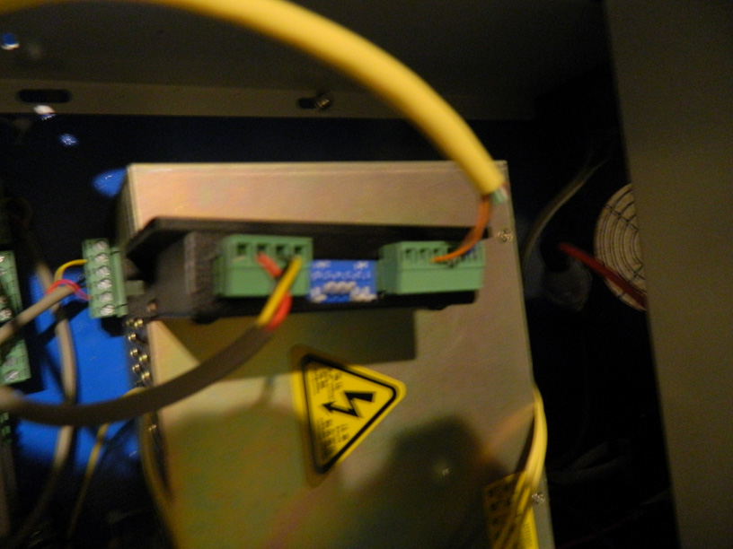

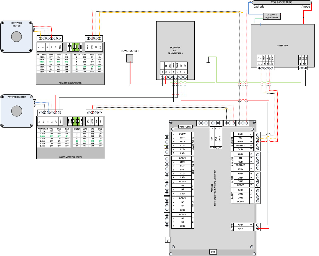

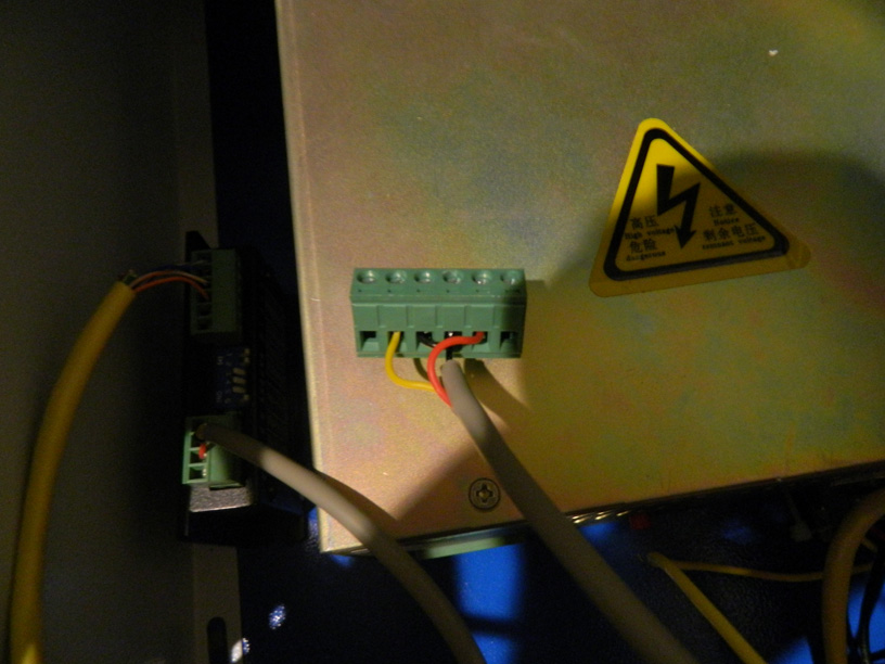

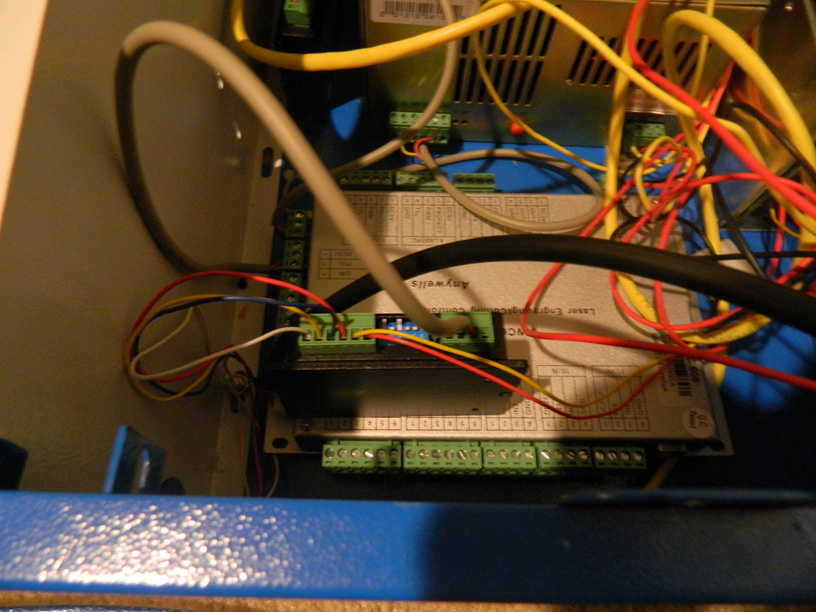

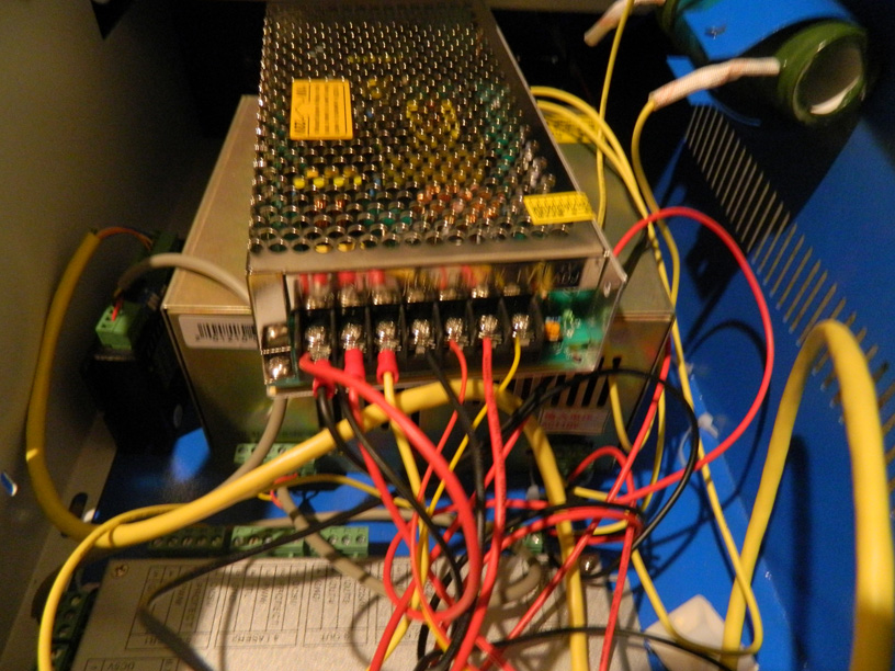

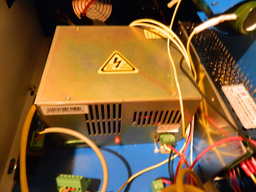

ok. I finished wiring the machine an it turns on but the laser doesn't turn on an the X and Y motors are not working (dont move). Th emotors make a noise like they are trying to move but don't move anything.
From panel and wiring I removed the test laser button, the Laser switch button, and the Regulating Knob.
I checked the wiring and I noticed that X microstep driver has no power. (The green LED is not on.)
I kept the Laser PSU so I kept the green resistor.
The Laser PSU has one 1 LED light turn on. The WP.
As for the DC24V/5A PSU, I changed the voltage to 110V instead of 220V.
I didnt buy any limit swtiches, or a DC Digital Meter, so I kept the analog mA reader that came with the machine.
I edited the wiring image found here to reflect how I wired my machine. i also posted pictures to illustrate what I did.
Can someone please tell me what did I do wrong?

That diagram is still incomplete. There should be the same power going to the x axis stepper motor driver as there is to the y axis.
there needs to be a bridge connection between the WP and the GP connector on the laser PSU

I did do that, but the laser turned on once and didnt do ahything more.waltfl wrote:there needs to be a bridge connection between the WP and the GP connector on the laser PSU
ronguerrero
- Posts: 7
- Joined: Fri Mar 22, 2013 5:18 pm
not sure what you mean by "turned on once". did it fire? or do you mean the laser PSU enabled the laser once.
on the lightobject psu, there's an indicator if the laser is enabled/disabled.
in general, i usually test my system in components before I make all the wire connections. its easier to debug.
- 24V PSU (does it power on when I connect power lines)
- Laser PSU (does it power on when I connect power lines - make sure laser tube wires are well isolated just incase)
- Controller (does it power on with 24V PSU)
- X Axis (stepper, driver) - can I control it with LCD panel
- Y Axis (Stepper, driver) - can I control it with LCD panel
- Laser Tube
Laser PSU WP - is the laser disabled if WP connection is open? - indicator on lightobject laser PSU
Laser PSU WP - is the laser enabled if WP connection is connected to ground? - indicator on lightobject laser PSU
Does the laser tube fire? - cardstock in front of first mirror (the one the tube points at)
hope you get it all sorted out soon. it's a great machine after the upgrade.
