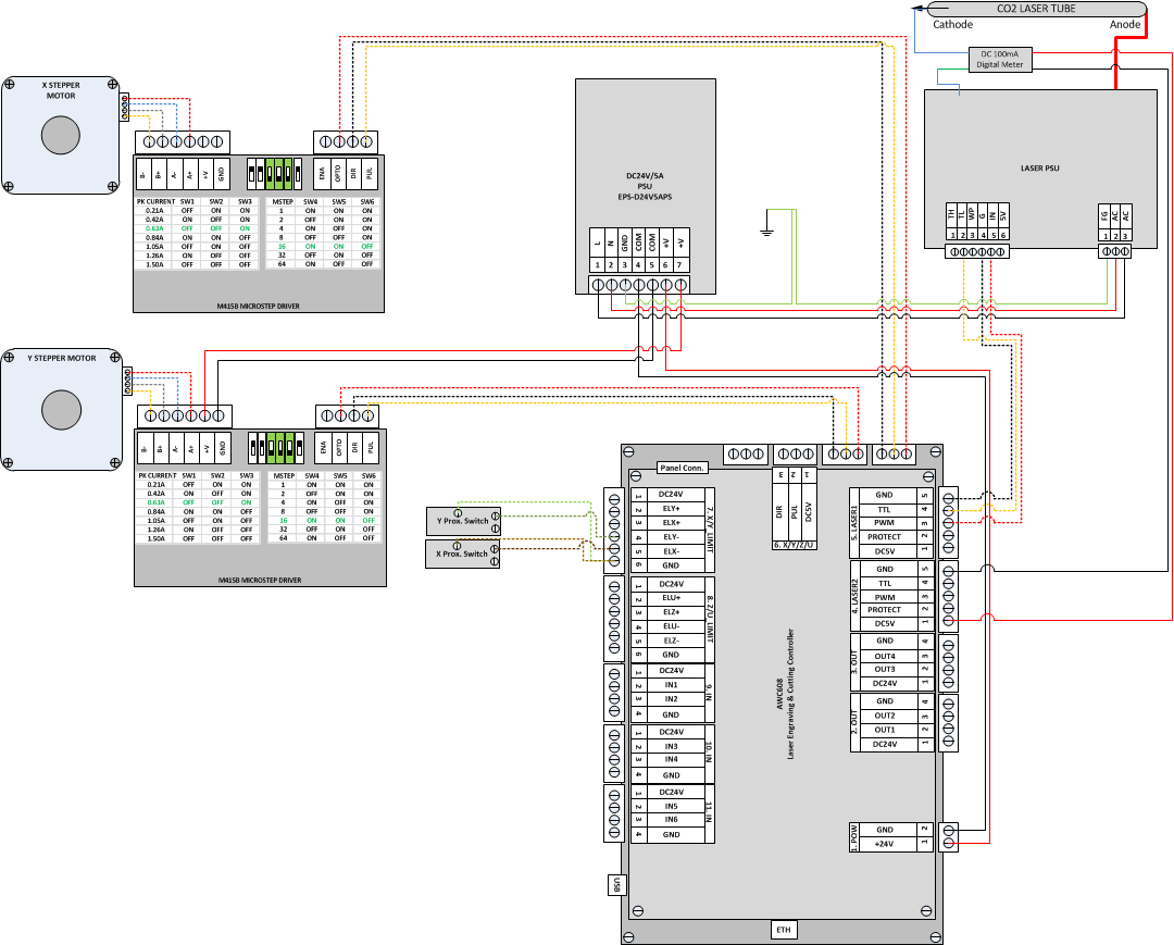

Thanks Marco, you are more than welcome to use the diagram. I am not sure if you use Visio, but I created Stencils for everything you see there if you want it.
BTW, my motors are working fine...as I mentioned below, I had ELX- and ELY- switched around and that caused my issues. I just wanted to let people know that may be their issue if they are having problems.

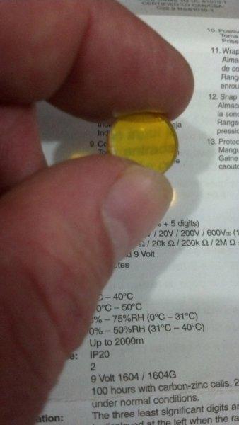

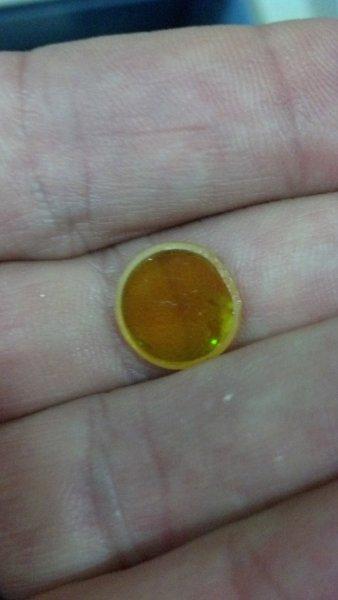

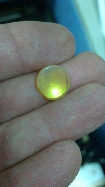

As for the power, I have adjusted the max power to 58% in LaserCad which running at 6mm/s is hitting 17-18mA. However I am still having issues getting it to cut. I just did a Saltine Cracker cardboard box and it took 6 times to finally cut through it. I looked at the lens, and some of the coating seems have worn off. Do I need to get a new one?
See me a picture of the lens. It's very important to have a good focus lens

Here it is.

Hi
this lens are gone it must be clear and no scratch at all

No you are right. It will hold an 18mm...I did not realize there was another part that unscrewed inside. Also here is the diagram with the meter...is it correct?

Understood Marco. As for the acrylic panel, do you have a LaserCad file already done up that we could use to cut one out? If not I will try to come up with one when I have a chance. Also was the new diagram correct with the meter?

It's almost completed but I don't think it's a good idea to draw 5V from the DSP controller. Reason 2: prevent any 'discharge' feedback to the DSP controller. 2) DSP controller supply up to 40mA current but the meter does need 80mA. Even though it works, but it is under current. So, I would suggest to use a 24V to 5V isolated power module to get power from the DC24V 5A (or 15A) power supply instead.
