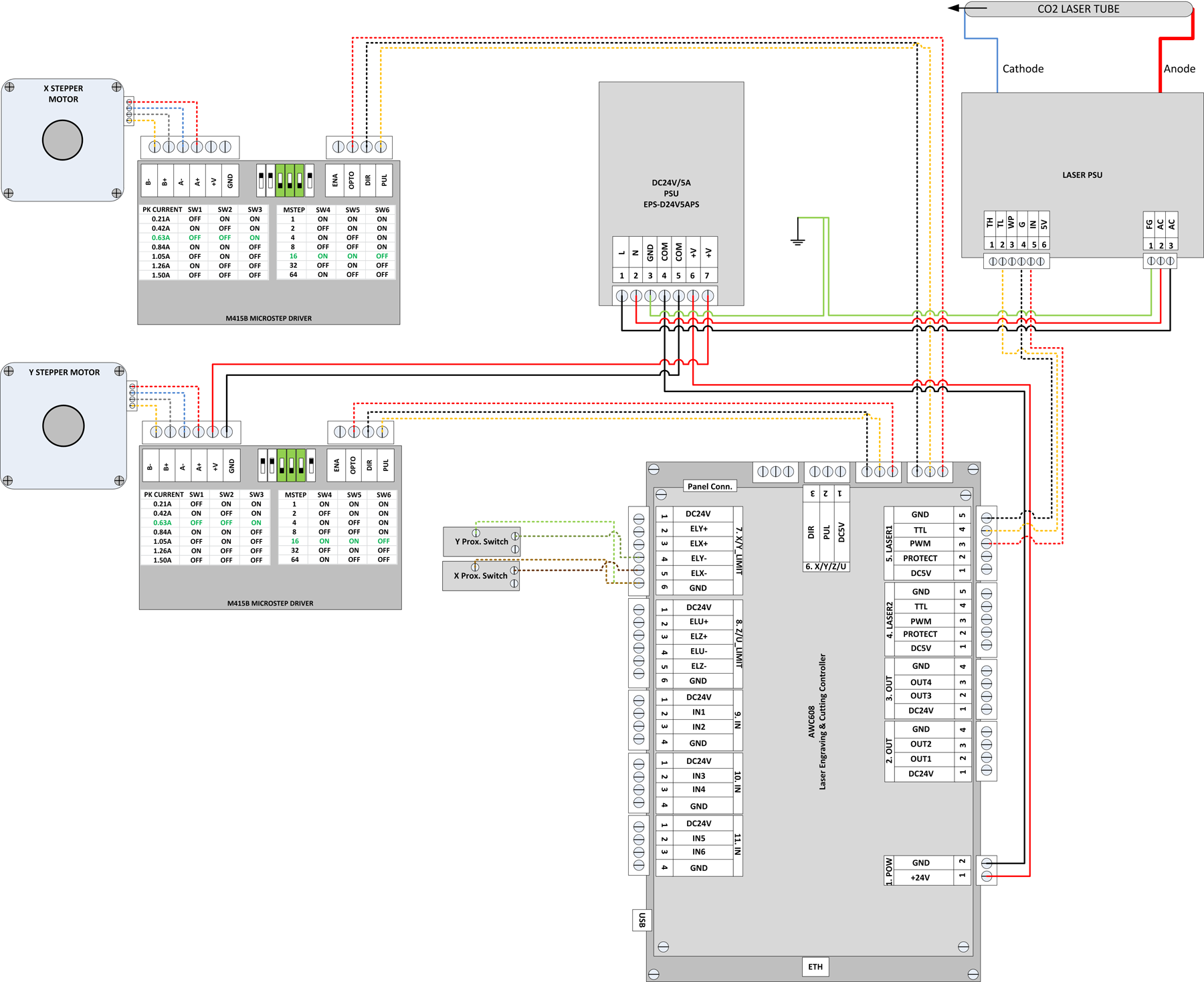

Ok I have FINALLY finished my DSP AWC608 conversion. Just as a disclaimer, I know little to nothing about electronics and it was still pretty easy to get setup. I have attached my wiring diagram if anyone would like to look at it.
I do have a couple of issues though.
1. As I mentioned I have limited electronics knowledge, and I need to hook up the DC 100 mA digital meter that was in the kit. However I cannot figure out where the input +/- wires are supposed to be plugged into. In Marco's description he says to wire it in series from the negative of the power supply to the laser tube. I assume this is on the cathode side of the tube, but as for the PS-, is that ground or something else? I have no clue and don't want to fry the meter.
2. The laser does not cut anything thick at all. I have some 3mm board that I have been trying to cut without success. I have tried slow speed (6mm/s) with a range of power (20-90%) as well as a bit higher speed and have not had any luck. I have tried to re-align the mirrors the best I can and it looks to be ok. If I cut a box around the whole working area, it is all the same thickness and looks good. As for focal point, I am a little lost. My deck is not adjustable, so I started playing with adding something under the wood to raise it up. If I set the wood on the deck and do a cut, the lines are very crisp and small. If I raise it even 3mm, the lines start to get fat. Just as an FYI, I am approximately 65mm from the top of the head mount to the working surface if I put the material on the deck.
**Proximity Wiring Warning** Please be aware if the stepper motors are acting up when you power on the machine, it most likely is due to having the ELX- and ELY- wires flipped. When I powered mine on, it would go to the home position and just sit there and "chatter" is the best I can describe it. Or the X axis would go to the far left and bounce back and forth against the proximity switch. So if you run into this please check the wiring for the switches.
Shane:
Your diagram is an excellence and I don't see any problem with that. May I used it for supporting other folks?
Regarding the meter, "Yes", that was what I mean. Put + /- in series with the Cathode (break the blue line and put the meter in between). If you can, can you redraw it with the "mA" meter installed?
By the way, 27mA is too high to be used. It will hurt the tube and you won't get over-power but less. So, make sure that it is not over 18mA for a 40W tube. Note: the K40 is not a true 40W tube but 32~34W only.
Check the X limit switch. I look like that it's a faulty switch or lose wire connection. If the limit switches are installed on the Top-Left, make sure the LaserCad setup is also set to "Top-lef" on Worksapace set up. Password: "608" to save new setting
