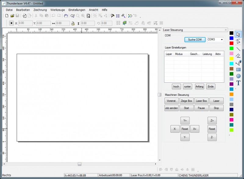

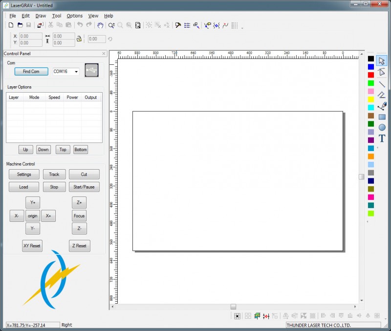

Telrad
- Posts: 123
Re: Awc 608 Problems

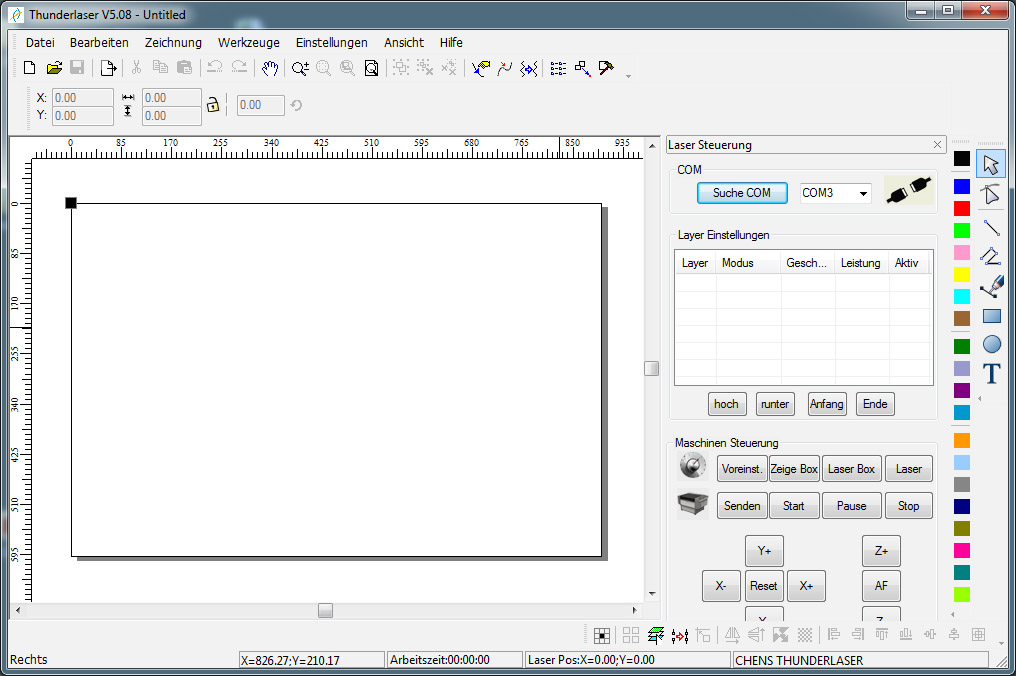

Why does his software for almost the same controller as ours look so much different? His labels on his buttons are more accurate and it looks like someone tweaked the layout a bit better.
I'm not taking any sides... I'm just asking a question as to why there is a difference.

I don't think there is a big difference, but decide for yourself:
old PHCad V 4.47: new PHCad V 5.08: Thunderlaser's LaserGRAV: Anywells LaserCAD:
The PH-Controller uses a DSP-Chip (Texas Instruments) together with a FPGA (Field Programmable Gate Array from Altera). Both designs have advantages and disadvantages:
- using one DSP only makes updates with USB-Stick possible (more correct is to say, that this way of firmware update is impossible with PH-Controller cards design)
- The one DSP (running at 150MHz) in Anywells AWC608 does calculate everything, the DSP (running at 225MHz) in PH-controller can outsource lots of basic calculations to the FPGA-chip and gets that way more headroom for high-speed-working
There are lots more of little differences between Anywells and PH-controller, but at the end they both just run and do a great job.

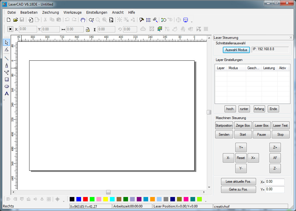

The answer is easy: PHCad, LaserCAD and LaserGRAV are all based on the same software, but edited by different engineers.Telrad wrote:Why does his software for almost the same controller as ours look so much different?

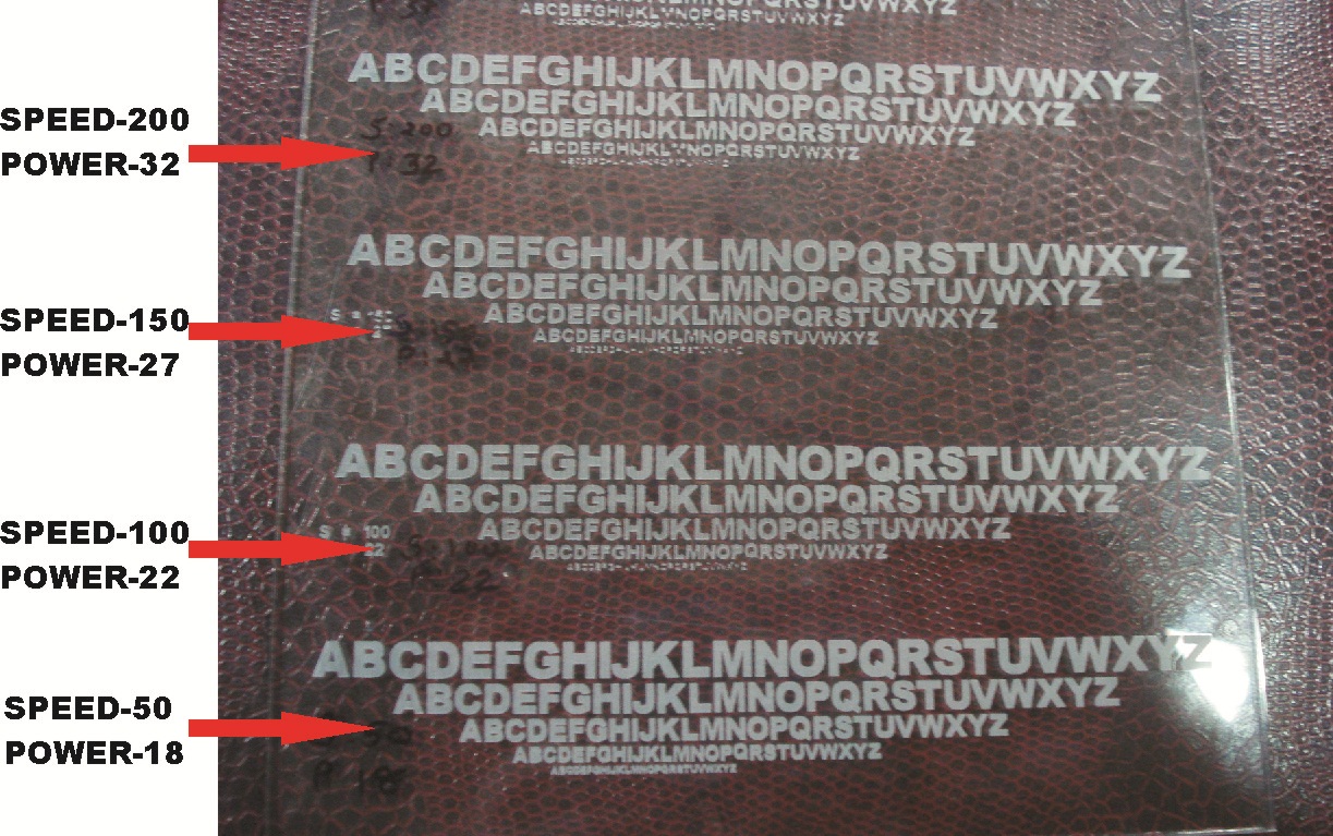

Dear Mr. Marco
As you know i am working on the High Speed Engraving machine. I am facing problem is that when our design ( job ) width is thin like later, straight line, etc..
then our machine can not engraving that same. for more information please check attached photos.
