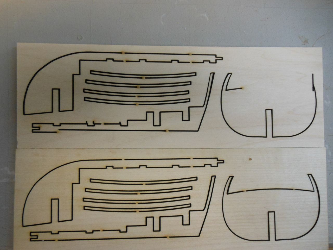

Here is a photo of some parts I cut out.
The parts were cut from the same file on both billets. The lower billet was cut last week. The upper billet was cut today. As you can see the parts in the upper billet are all messed up. As a matter of fact, that last part on the right hand side didn't finish. The laser suddenly started cutting erratically and then it just stopped cutting and shut off with the axis not moving. I had to actually turn the machine off to get it to reset.
What is causing this? Is it a bug in the controller or something else? Has anyone else encountered this sort of erratic cutting behavior? I put an AC filter into the incoming AC line to filter out noise.

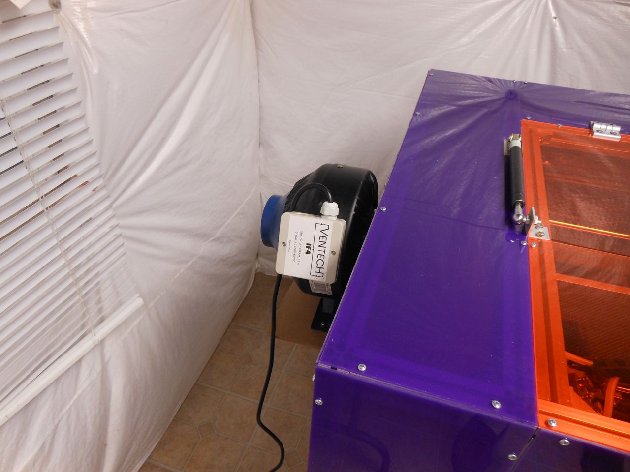

The most recent modification I've done to the machine was to add a second exhaust fan. The second fan is attached to the left upper side of the machine near the cutting table as shown in this photo:

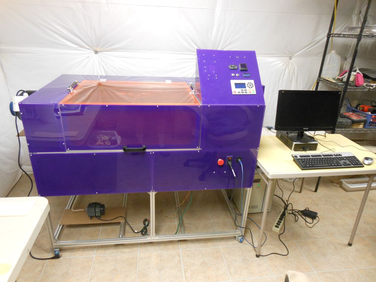

I currently have this exhaust fan plugged into an extension cord drawing the 110 volts AC directly from the wall socket. The other fan is in the back and it is a 12 volt fan drawing power from a 12 volt power supply inside the machine. Here's a photo of the complete machine:
