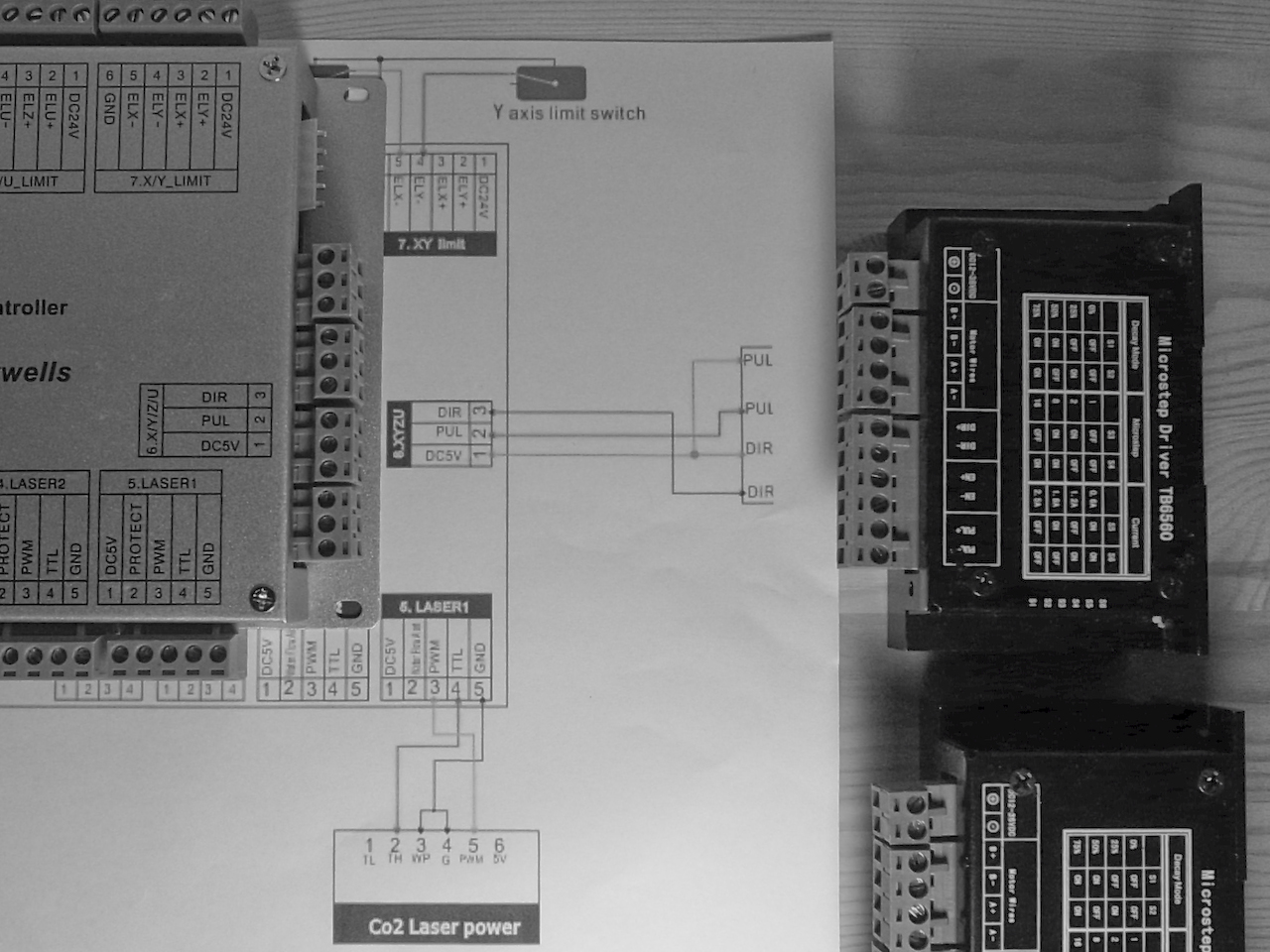

does anyone have wiring diagrams for this stuff.
its sure fun to figure out how to wire it, sort of like figuring out a new cellphone, but i really dont want to take chances with this stuff

Hi concretevapor, if you do a search for Tim Wehr you will find he has written a lot on how to set up the DSP and also a circuit diagram of where to put things.
About the only thing that is really critical is the power in wires but they are marked very well so that shouldn't be an issue.

Re: wiring diagrams for DSP2012, stepper controllers, power.
thanks marko the diagram is helpful
rich, thanks for the info, is he in this forum also or?

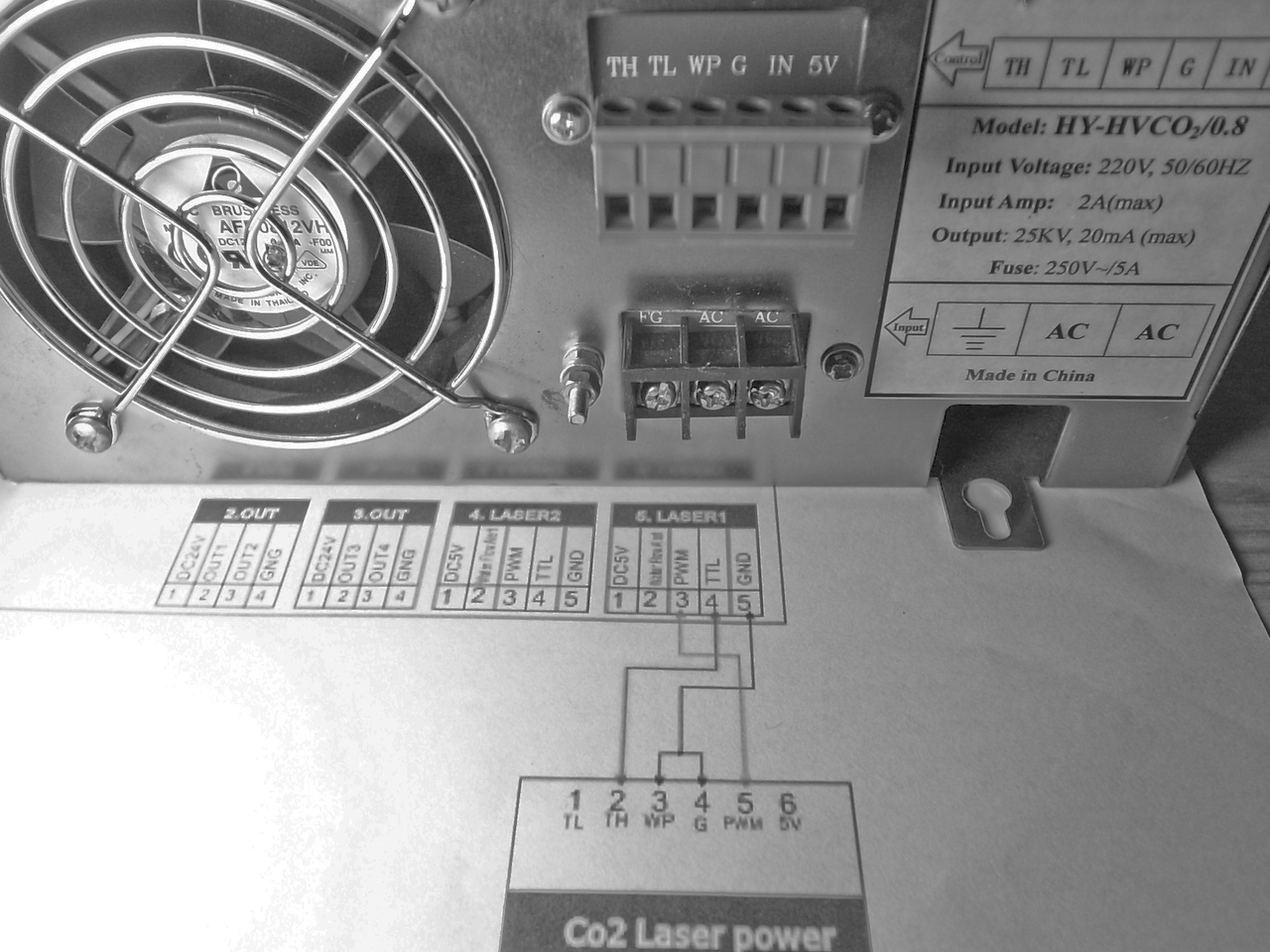

for the power supply connection, on the diagram for port 5 it says "PWN"? "P/IN"? vs "IN" on the unit itself. i am curious what they mean, i couldnt make out what it said on the diagram it was a bit pixellated
where does the second micro stepper driver go?
what gauge wire do you recommend for this?
thank you
There in the picture are 4 block connectors for 3 wire each and from left to right the order is: plug one (X), plug 2 (Y), plug 3 (Z) and 4 (U).
In my system I only use X and Y and my micro stepping drivers are very similar to yours and they will do a very good job once you adjust them.
As far as the wire goes I'm using # 18 and it does just fine. I hope it helps

the funny red cable that comes from the laser tube power supply which resembles an antenna..it is a screw on cable...
i assume it is the power cable that has to be connected to the laser but cant be too sure.
if it is so, would it matter if i splice it to the existing cable or properly solder it onto the tube?

Yes, the red cable coming from the laser power supply is to be connected to the laser tube. The smaller wire that comes out of the PSU is to be connected also.
I would advise against soldering to the tube as you may crack the glass from thermal expansion.
Yes, best to wrap the cable around a couple of times and just clamp it with an aligator clip or use a BNC connector made for earth wires. (the one with 2 screws on it).
Even though the voltage is around 20K volts there isn't too much amperage to burn things out if you have a loose connection so clamping the wire on is ok. Just make sure it is a good connection though.
