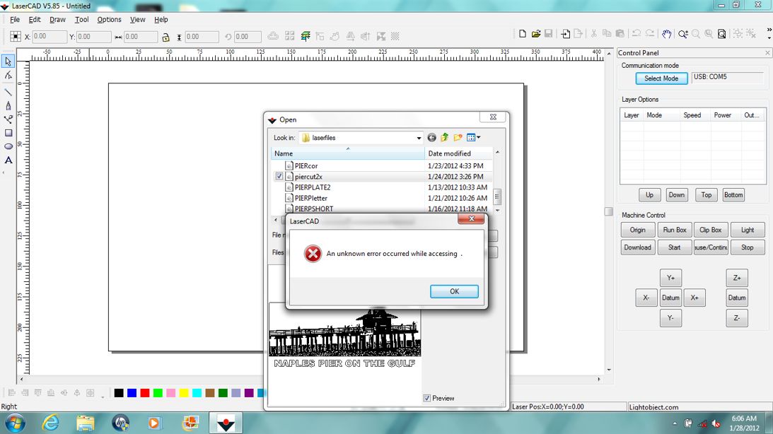

Hi marco,
now it gets redicoulus I safed a couple files to my hard drive from LC 5.85 a few days ago after the jobs was done
and yesterday I try to open them and I couldnt the message comes like before " an unknown error occured while accessing" see screen shot
hey thats not normal because some other files have no probleme something is wrong I think I go back to the previous version untill all this bugs are squared away.
this programm needs to be generally worked over not just adding patches .
according to TI engeniers maker of the DSP processor " if one part of the software is changed the rest of the program needs to be intensive tested because the DSP has internal software connection who can influenc the rest "
I did not have this kind of problemes with the previous versions there i could even open and load safed files from the first version.
LaserCad_V5.85
dkc
