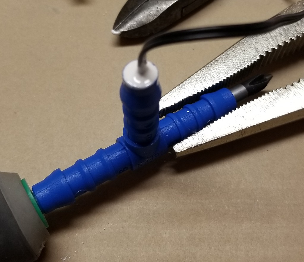

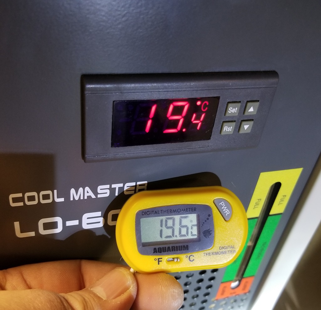

After installing the new 60W SPT tube and power supply, I fired the machine up and the chiller came on, but it wouldn't shut off!
It turns out the 10K thermistor in the bottom of the coolant tank quit working - for some reason?? (I flushed the coolant twice before installing the new tube, so who knows...) To fix it, I potted a new industrial-quality stainless 10K unit into a plastic tubing tee, and installed the tee into the output line from the pump in the chiller. (see attached images) I mixed some titanium dioxide into the epoxy to strengthen it, which is a trick I was taught as a green kid in aerospace.

After all the new parts were installed and the tube and mirrors aligned, it likes to cut 3mm clear cast acrylic at 10mm/second with 55% power. What's interesting to me is that 55% PWM reads 14mA with the coolant at 17.2C, and 13mA with the coolant at 20.8C. I have the chiller set at 20C, with 2C differential and 0.8C hysteresis. The temperature of the tube definitely makes a difference. I thought about reducing the differential temperature to 1C, but that would make the chiller cycle on/off quite a bit more often.
