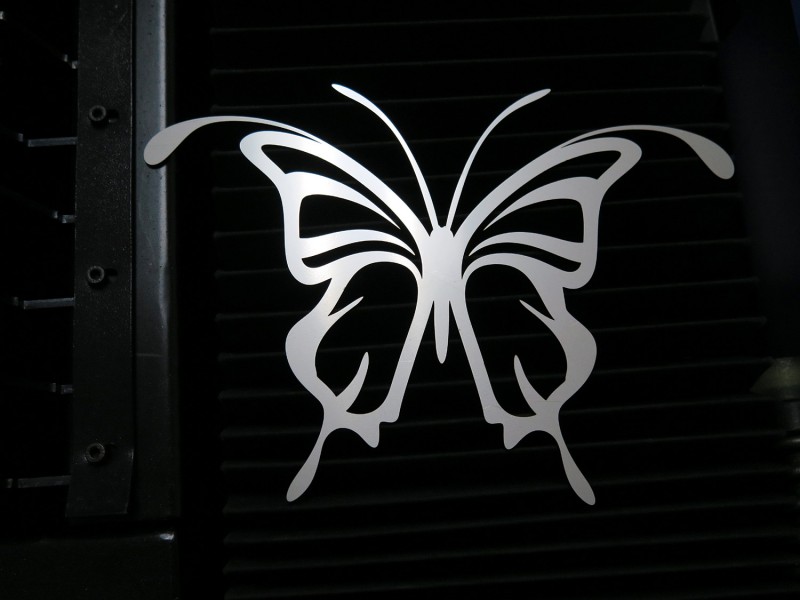

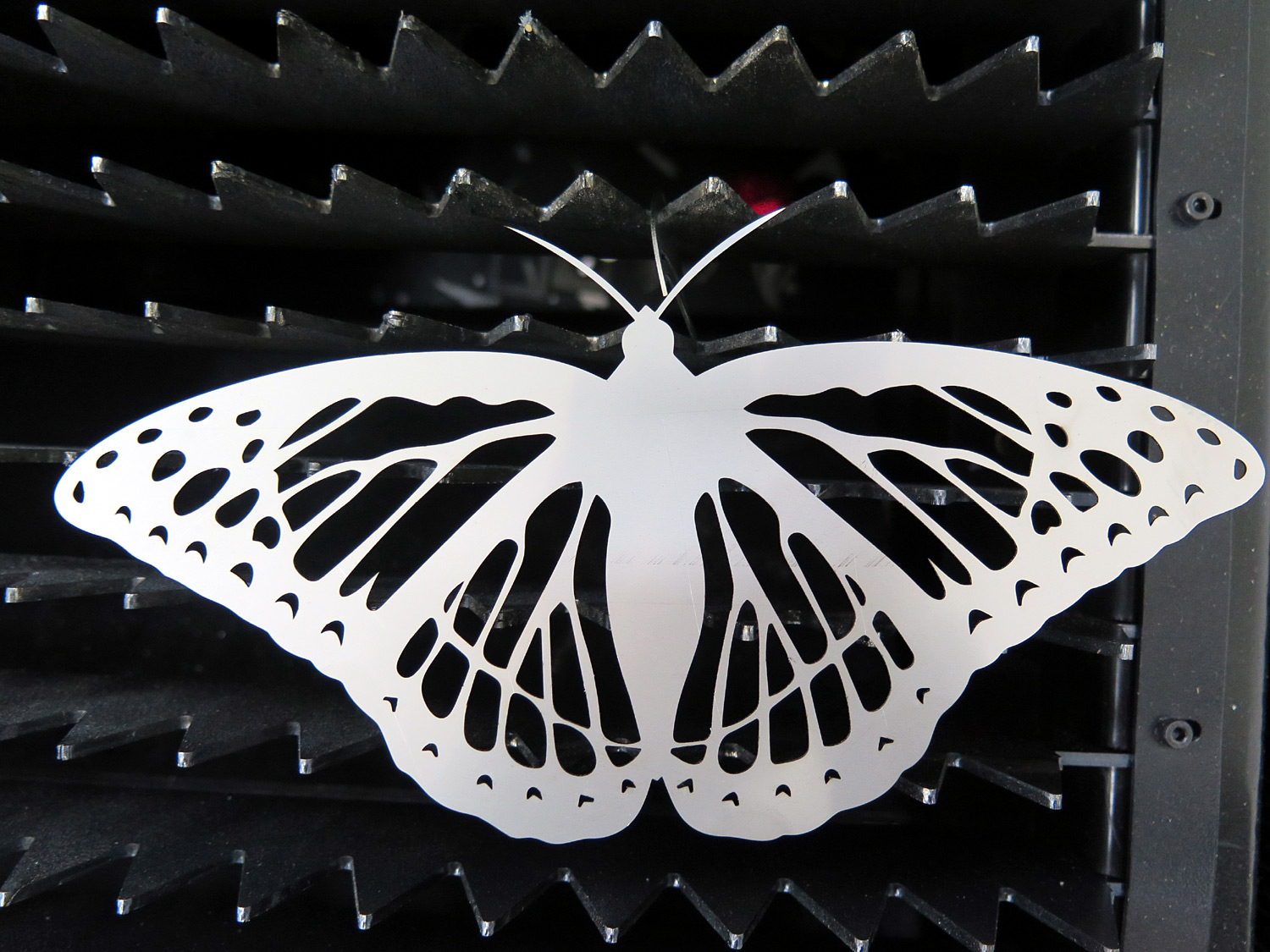

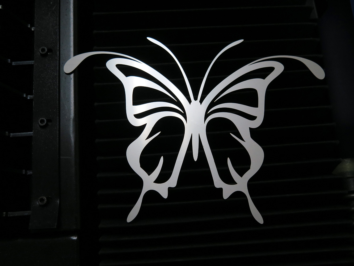

I have setup a 700W fiber optics metal cutter in our demo room not too long ago. Just completed a few samples and want to share with you folks
Basic info:
Material: 1mm stainless steel 304
Power: 700W
Speed: 300mm/s (1ft/s)
Gas: Nitrogen
