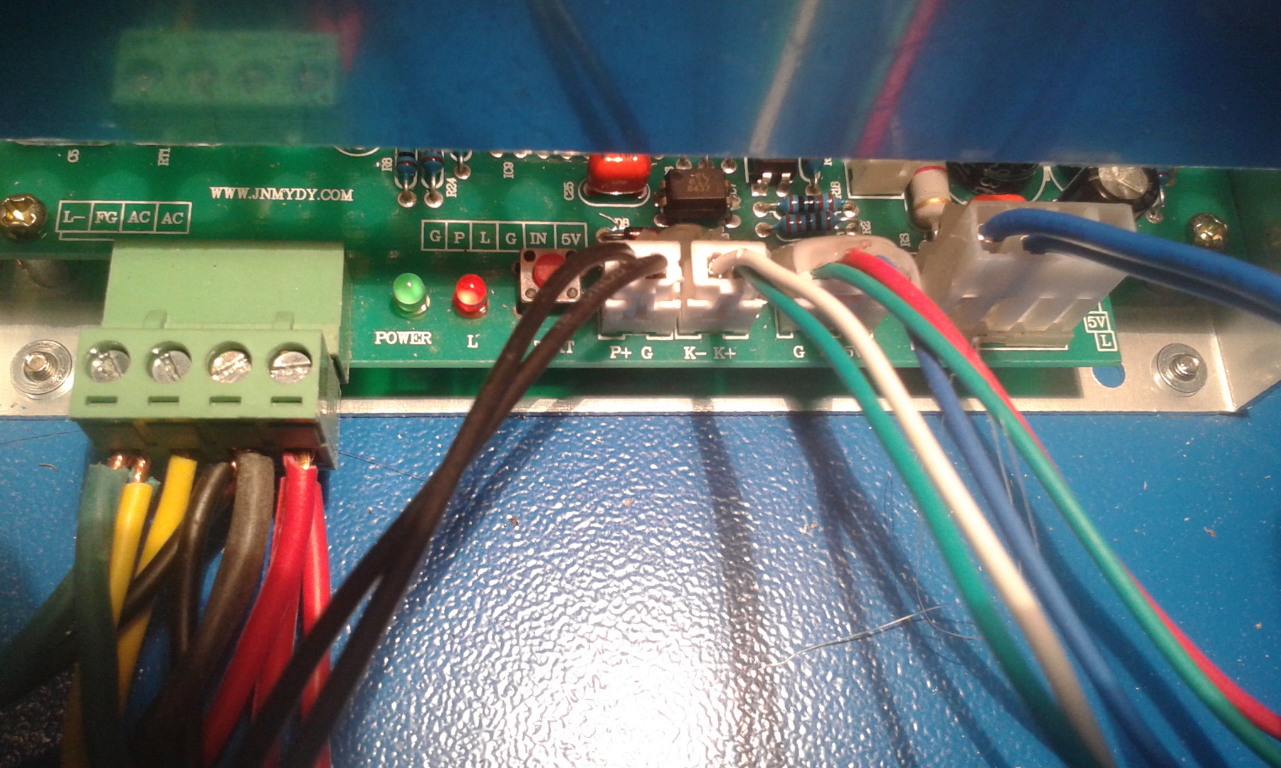

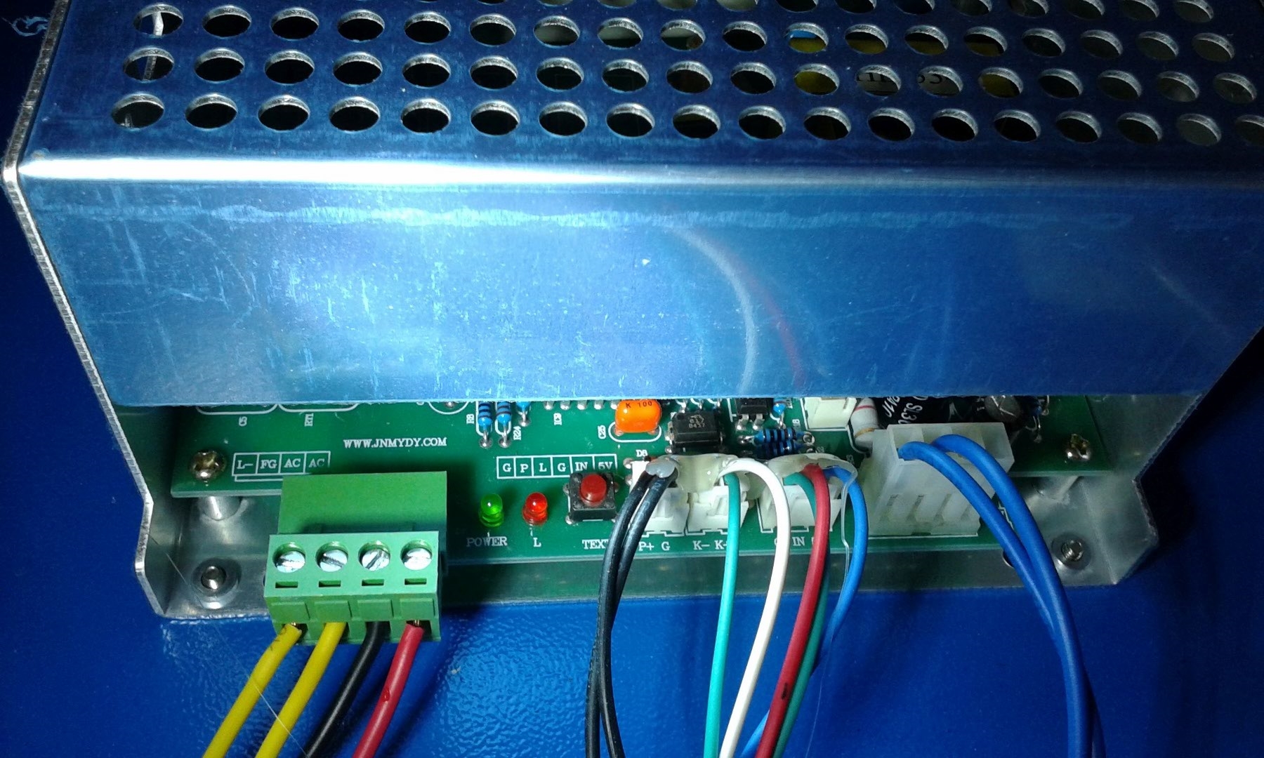

I just got my upgrade and my Laser PSU doesn't look anything like what I have seen on the discussion boards. Can anyone shed light on the pin outs? Attached are some pics.

It seams the our brothers across the seas were never consistent with power supplies and color coding. Here is the power supply for the k40 I got. The left connector , the black and red wires go to the power switch, one yellow goes to the analog meter , the other yellow goes to chassis ground. The two black wires go to the laser switch. The next connector has white and green wires. The white one goes to the test switch and one of the green ones go to the test switch, the other green one goes to gnd on the red Moshe board. the connector with the red green and blue wires go to the current reg potentiometer and the right side connector with two blue wires go to the red Moshe board. The amp meter has one yellow wire going to the left connector and a blue wire going to the output end of the laser tube.

we after a weeks worth of working for a couple hours each night I have the K40 upgraded with the E5 DSP controller and was able to figure out most of the wiring. The only thing I have not been able to figure out is what wire from the Laser PSU goes to the TTL connection on the E5 DSP controller. Would it be the blue wire that was connected to the (Current Regulation) Potentiometer as the G & IN wires were connected to that POT and they go to the GND and PWM on the E5.
Also with the upgrade to the E5, do I need to the Laser switch (two Black wires) and the Test switch ( white and green wires) or can I just disconnect them from the Laser PSU along with the Two Blue and one green wires that on the Right hand connector that says it is GND, 24V and 5V.

Give this a try:. Shorted P and G together (Laser switch, two black wires). Then, connect TTL to K+
I think it should take care that

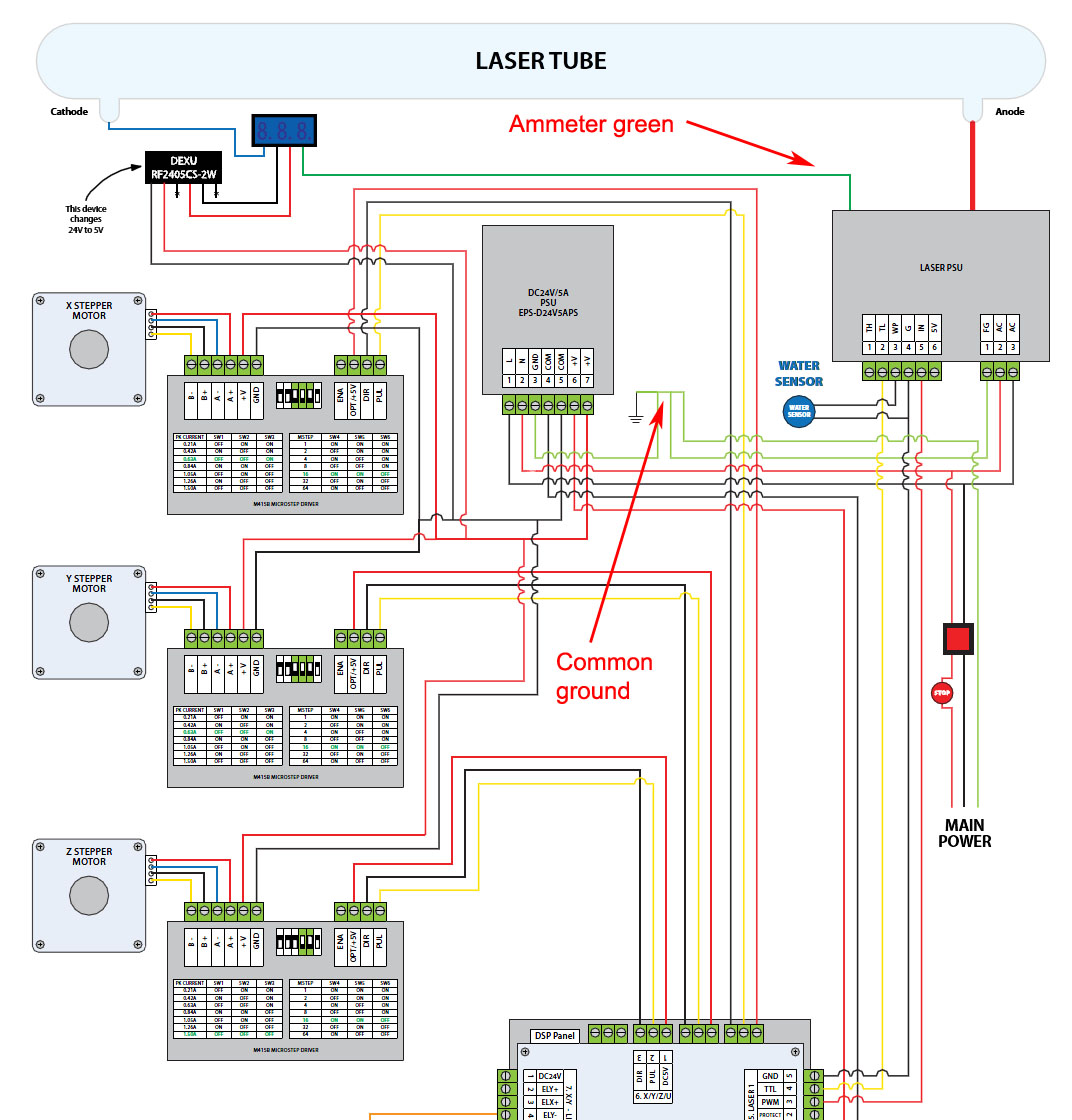

Per the x7 connection diagram:
All the grounding is all tied back into FG
- chassis
- 24v psu
- laser psu
Couple questions:
- Where else can the green wire for the ammeter go? Can it connect to FG?
Please refer to annotation on the connection diagram below: Edit:
Someone correct me if I'm wrong but after taking an Ohmmeter to FG and the laser PSU, it appears to be tied in together
- chassis
- 24v psu
- laser psu
Couple questions:
