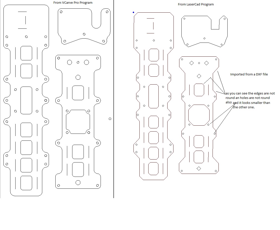

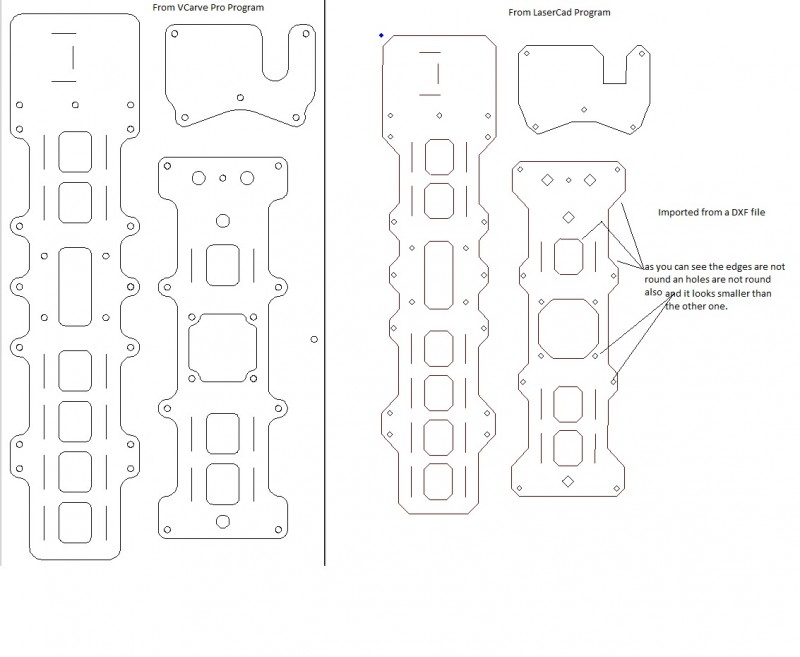

Do I really need LaserCad?. Is there another program that I can use, I opened lasercad an found it a bit useless, when open a DXF file all the holes turned into squares!! an that layer by colours was
not working as it started with engrave an black colour, worked out how to change to cut, but the colour thing is a bit annouing an can't delete a colour if required, as for drawing anything, you can't edit
the drawing, accually the whole DXF file was a complete shamble. None of the corners were rounded an holes square or diamand shape.
So far I'm not empressed about the lasercad prog.

here is an example of what I am saying, ok I don't have the laser working atm so it might come out correct but by looking at the pic I just don't think it would.

ps - I've just had a closer look at your pictures - very odd! I've never had LaserCAD do anything like this to any of my input!

A friend and I are also having the same problem with dxf exports from Vectric Aspire v8.012 to LaserCad 7.09.
I have found that if you export to AI and then import to LaserCad that the file is correct but the problem is that you loose you're colors from layers.
I sure wished that this could be fixed in whichc everprogram that is causing the problem.
