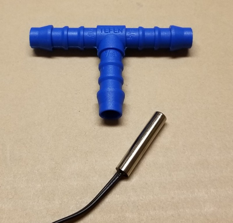

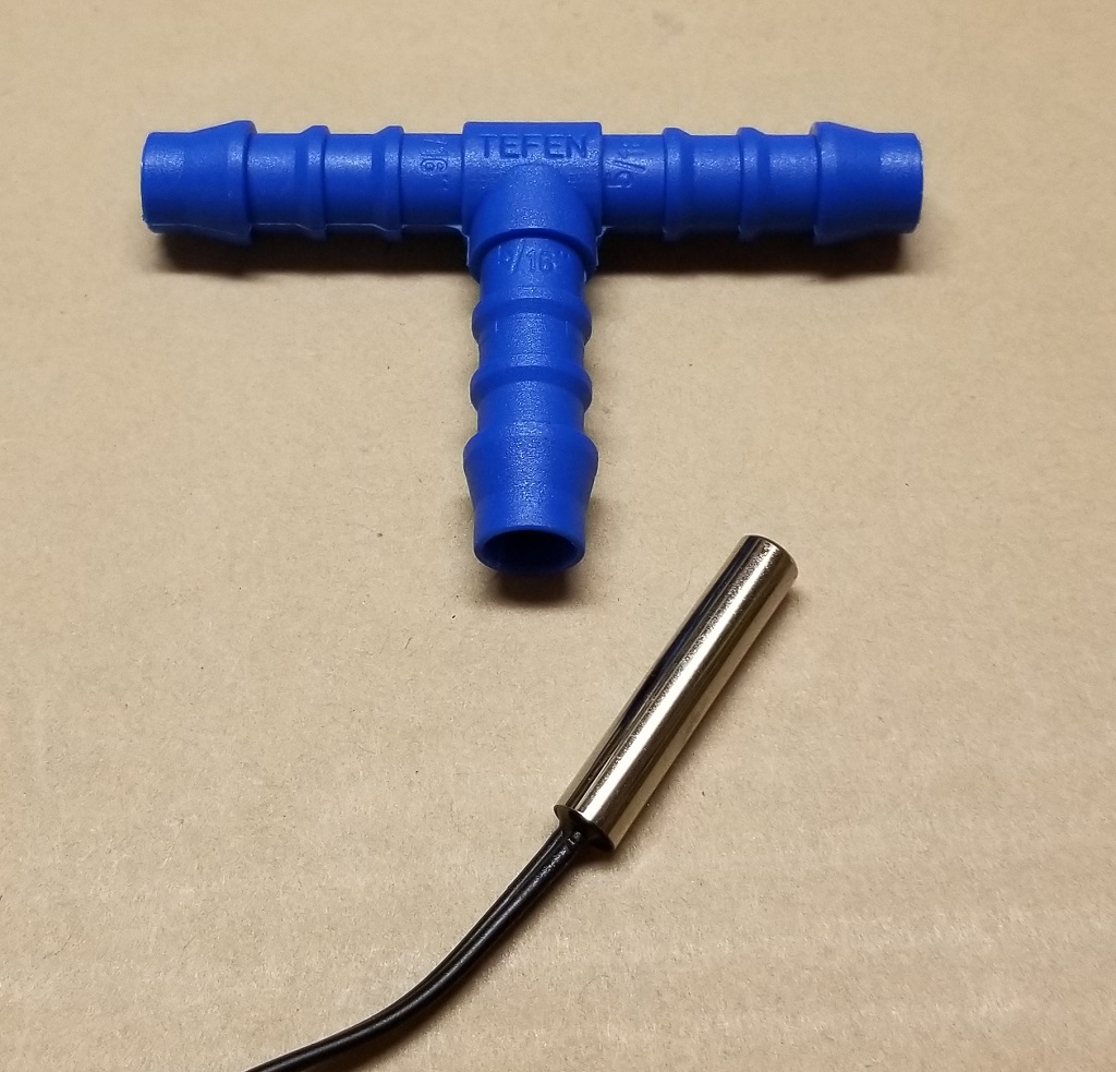

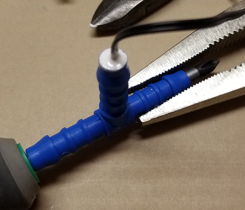

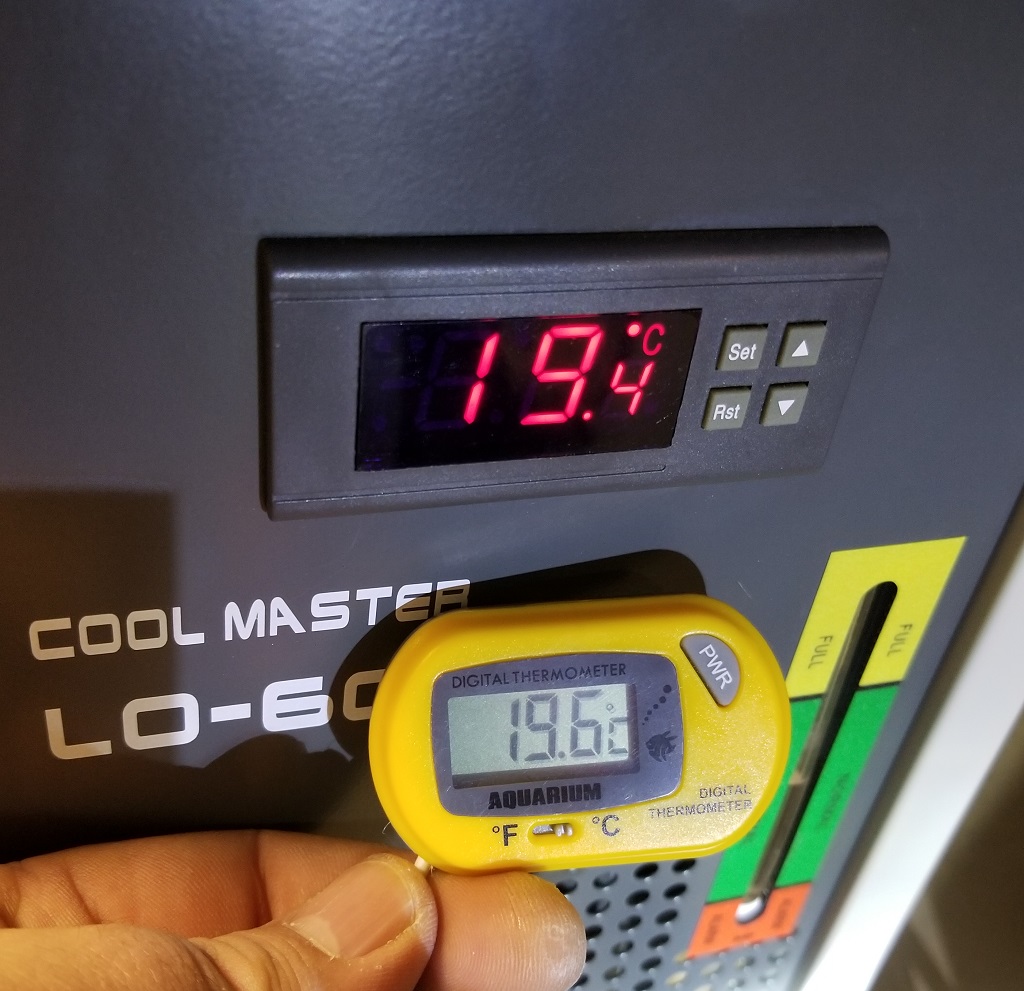

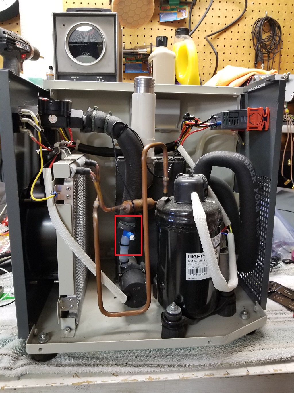

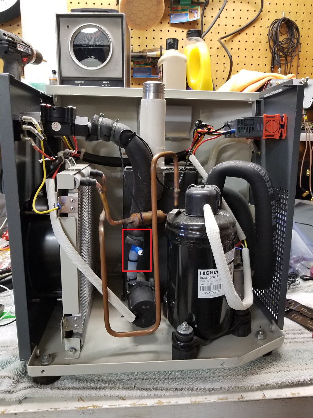

After installing the new 60W SPT tube and power supply, I fired the machine up and the chiller came on, but it wouldn't shut off!

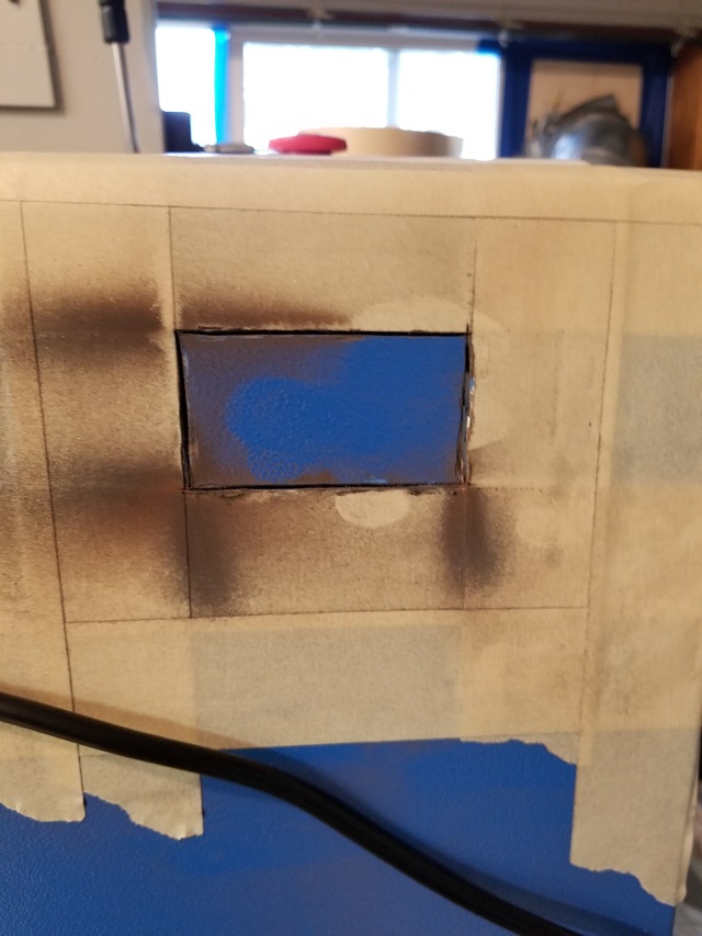

It turns out the 10K thermistor in the bottom of the coolant tank quit working - for some reason?? (I flushed the coolant twice before installing the new tube, so who knows...) To fix it, I potted a new industrial-quality stainless 10K unit into a plastic tubing tee, and installed the tee into the output line from the pump in the chiller. (see attached images) I mixed some titanium dioxide into the epoxy to strengthen it, which is a trick I was taught as a green kid in aerospace.

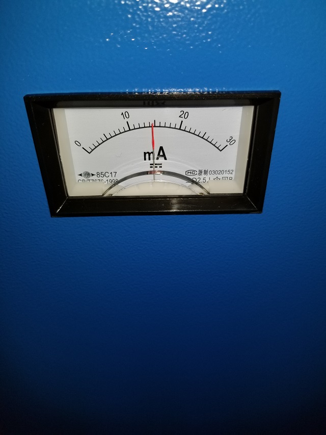

I also installed one of the new 30mA meters I got from Marco. MUCH better quality than the flaky meter I had bought earlier through Amazon.

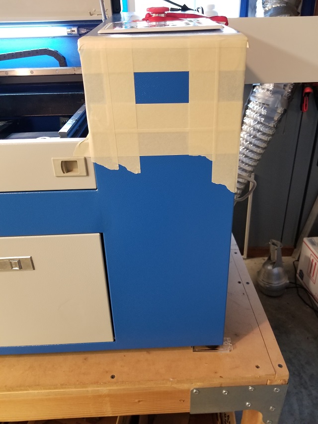

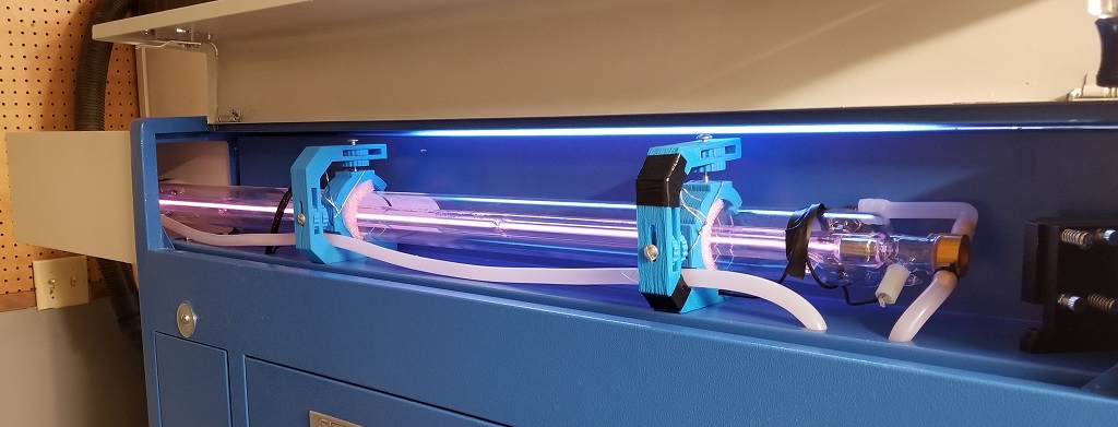

I really like the bezel mounting system too. I used a rotary tool with a cutting disk to cut the mild steel in the front of the cabinet, then installed and wired the meter. I used 2 sets of 2 10A10 diodes back-to-back to "clamp" the cathode circuit close to chassis ground in case the meter movement opens or the cathode wire breaks. With 2 diodes in each string, the cathode cannot go more than 1.4V above or below chassis ground. It may not be explicitly necessary, but it makes me feel better.
After all the new parts were installed and the tube and mirrors aligned, it likes to cut 3mm clear cast acrylic at 10mm/second with 55% power. What's interesting to me is that 55% PWM reads 14mA with the coolant at 17.2C, and 13mA with the coolant at 20.8C. I have the chiller set at 20C, with 2C differential and 0.8C hysteresis. The temperature of the tube definitely makes a difference. I thought about reducing the differential temperature to 1C, but that would make the chiller cycle on/off quite a bit more often.
